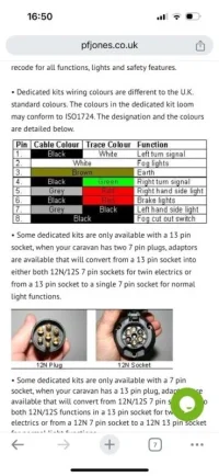

I have followed the wiring diagram according to PF Jones website and am still having the same problem.
I've just had my meter on the pins and every pin shows a voltage except for pin 2 - the foglight.
I have switched the foglight on and nothing is sent to the pin. I have pressed the switch in (to open the contact) and still see nothing at the pin.
