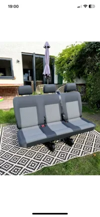

Hi guys sorry I’m new to this but I have just purchased a t28 highline and looking to convert it to a Kombi. Will a triple bench seat (see picture) fit?? If anybody could point me in the right direction of a video or description of how it’s done that would be much appreciated. Thanks
Yes they will fit, it’s the alternator to 3 singles or a single and a double. You will need 4 floor brackets, underneath reinforcement plates and nuts. See this video for a rough how to
The floor is pre stamped with the positions so most of the guess work is removed
