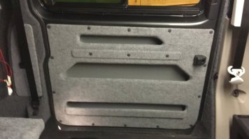

Hi, thought I would post some pictures of the Kombi conversion I'm slowly working on. The idea was to turn the van into a welfare van after a day of watersports. So the plan is to;
Sound deadening
Thermal insulation
Carpet lining
Add a leisure battery and DC to DC charger
Add some electrics in the back
Put in a slidepod so I can remove it if I need the space
I've been doing this is small stages over the last couple of months, a door one day, the tailgate another etc. Until I came to the carpet lining. I bit the bullet on Monday and started on the carpet lining.
So far I've stripped it, put in the sound deadening, thermal insulation, run the electrics in, and carpet lined the walls. Just fininshed the last wall today as the ply lining boards arrived!

I've added USB ports in both the B pillars. 2 12V sockets (one for a fridge and one for the Slidepod) and USB port in the back. Switched downlighters for the roof, reading lights for either side near the tailgate and touch downlighters for the tailgate. I also left a pull through cable in the tailgate as that was a bugger to get the cable run through and I might add a reversing camera at a later date.

I used the Transporter HQ hidden clips, they didn't look any different to other offerings at twice the price. They do need hammering in with a rubber mallet to get them in place. I found that you need to put them in with some mole grips to twist them in and then make sure that they move around in the hole in the panel. When you come to fit the panel they are then able to move to meet the hole in the metal frame.
Still waiting for the 54mm holesaw I ordered to put the led lights in the roof panels, hoping it would arrive today, but I think the storms put pay to that. I drilled the tailgate lights with a 51mm holesaw, but then had to use a file to make the width wide enough for the lights to actually grip and stay in place.

Today I have discovered that the hidden clips don't work completely in the roof panels. I have gone with 2 seperate panels for the roof lining as per the OEM panels, only out of necessity as I I don't have 2 pairs of hands to hold everything in place. The hidden clips held up the forward panel along the sides, but I can't get them to hold across the panel in the roof brace. I have now ordered some longer roof clips from MVM as Harrisons don't seem to sell the same type. I wanted to get the van back on the road this week, but looks like it may be next week now!

I put some masking tape around the roof edge and marked where the holes were on the tape. This helped when trying to line up the edge clips in the roof panel as you can feel the hidden clips when you run your hand along the carpet. Once I had the sides clips in, the cross beams clips are lined up and push in to the holes, but don’t hold in place, probably due to being slightly too short.
