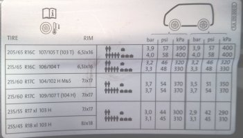

If it's a help this is the tyre pressure plate from my MY21 T6.1 Caravelle
I run 255/45 R18 which should put you in the right ball park.
