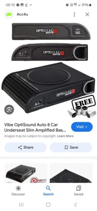

Having looked, the usual sub enclosures won't fit because the nut on the underside of the Sportcraft swivel is in the way. Does anyone have experience of a more shallow enclosure that would work?
Putting a sub under a swivel base will cut out a lot of the base sound wave. You might better looking to drop it next to rear wheel arch’s.
I'm sure we have fitted a Vibe active sub in a single seat base. But it was a good while ago so struggling to remember 100%
If it's the underside nut causing the issue for fitting the alpine then sportscraft offer this swivel with nut on top. It's mostly for leisure battery fitting but may give you the extra clearance you need.
