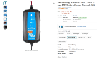

i think you would need a 10A or above charger to get over that, 5A is just too low for a battery that flat.
