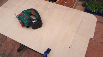

Hi, I'm probably a bit late to the party and I'm not saying these are better than Window pods, but they work well for me. I have one on each side window made out of 6mm 3-ply. The OS panel sits in a carpeted void and the sliding door one sits just on bare metal as I don't see any point in carpeting the door. I thought it might be of interest because they are held in by Neodymium magnets as was suggested earlier. This revised panel (below) was made over the last 2 days and they are removable in seconds.
Thanks for the thumbs up - I should mention, the glass side of the panels are painted matt black to give that 99% light block from outside. They are so dark it looks like fake glass. The other thing I do in the heat of summer is slip reflectix type panels in-between to reduce the internal temp but this makes them slightly visible though.
