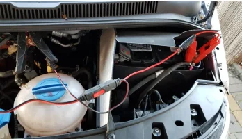

defo dont go on the NEG post for the charger. . . . only use the NEG post for a just start.
that becasue the sensor on the battery wont see the power coming in from the charger. . . .
use a chassis NEG point, like ligh bracket bolt or other.

As for your battery connection - the Ctek 5 comes with both crocodile clipped lead and a lead with M6 ring terminals. If using the crocs then its advisable to connect the positive straight to the positive terminal and the negative to a bolt on the chassis/framework somewhere away from the battery. This is because the second connection completes a parallel circuit and can cause a spark(s). If its at the battery, a leak of battery gas can explode! Whilst this is uncommon with modern batteries, manufacturers still advise you to make the second connection away from the battery for this reason. Your negative battery terminal will be wired straight onto the chassis/frame anyway so you are really just completing the circuit away from the battery. It is also good practice to make any final connection to a any battery on any vehicle when using jump leads - not directly to the negative terminal for this same reason.
I used the ring terminals on my T6.1 and wired them permanently to existing bolts at the battery terminals. They lead to the small orange female plug which has a rubber cap seal. I just tuck this down into the battery sleeve when not in use. When wiring these - you can go straight to the terminals if the lead is unplugged as there will be no complete circuit and hence no risk of a spark. You may even find existing bolt stubs at your terminals where you can hoop them straight on and fit extra m6 nuts without having to disconnect anything.
When you connect the charger (or extension lead if you've paid extra) - just pop your bonnect, fish out the lead from your battery sleeve and plug it straight in. You may be able to close your bonnet completely by tucking the wire around your headlight.
Lastly make sure you set it to the correct battery type. Its not always easy to tell as there is so much stuff covering the top where the labels are. Unplugging this could lead to some faultcodes requiring resets so unless you’re confident - avoid. I wrongly assumed that my 71 plate T6.1 DSG 150 7 speed with stop/start would have an AGM battery but it doesnt. In fact it has an EFB battery which is a wet battery on the Ctek charge mode. If you have the original battery fitted - your vw commercial parts department will tell you the type over the phone. I believe only Californias have factory AGM batteries but I may be wrong. Maybe those vans with powered doors as well?
