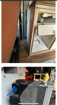

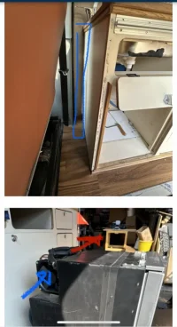

Thanks all. I has a read of that other thread too.
There's a marking on the fan on my fridge which shows it draws air from the left (looking at the front of the fridge) and exhausts to the right, over the fins, compressor and control box.
There's a 2-3cm gap between the wall and kitchen end panel next to the fan and the fridge is raised up 1-2cm on feet so I reckon that should be fine to allow air flow.
Will keep an eye on it in the summer and see if it's able to exhaust the hot air well enough down the back of the other cupboard.
