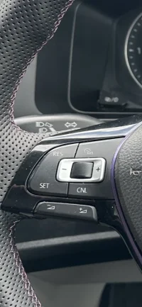

Sourcing the T6 buttons is the hardest to do. Plenty steering wheels fit but only T6 buttons will work on your T6
These are the buttons you are looking for.

Just remember the buttons on that steering wheel won’t work.
Steering wheel will be fine but no controls on it will work
