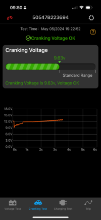

If you might have starter issues you could also try a BM2 Bluetooth battery monitor on the battery to check the cranking voltage, and it's a handy thing to have for the future anyway.

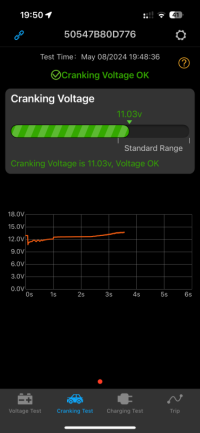

This is the info you can get. The BM2 is about £15-£20.
You could just put a voltmeter on the starter battery when cranking.
Battery seems fine as far as I can see from the BM2 app. It was 12.8v when I got in the van and cranking voltage looks ok. Typically it started fairly quickly during these tests, will
Try again once I get the long crank, likely tomorrow.
