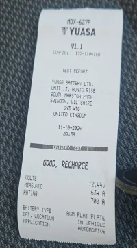

Thank you all for help. The battery is fine after the test. Looks like the alternator is playing. Screenshot_20241011_120911_WhatsApp.jpg
