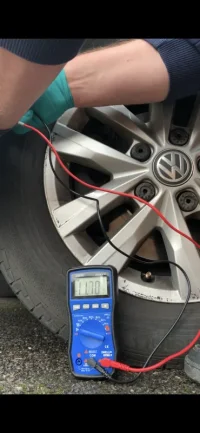

I have got 12v on my multimeter at the washer pump.

I have made some test wires so I can work from inside the van and not rely on the misses to pull the wiper stalk. (12v on them aswell and nothing on either washer pump)

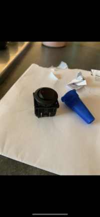

My temporary solution was hard wiring my wiper motor too the battery and piggy back the wiper fuse in fuse box. So I now have a wiper washer switch on one of my dash blanks. I ran the wiring though and cable tied it all out of the way. I also purchased a harness for the top of the motor so I had a good connection and then crimped the cables onto there (compared to when I was testing and just used female spare connectors). I then drilled and dremmeled the dash blank so I could glue my new washer switch onto dash blank.
