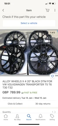

Hi I’m looking for a set of wheels that will fit a t32 I’m planning on lowering around 50/70mm anything considered thanks in advance

On checking that again you are correct in saying this though when checking you’re advising folks that a 102 tyre would work which I don’t think counts up either, what I found shows the T32 axle weights at 1710/1720 with a 102 tyre 850
My 101y’s are 825, I assumed four times that being greater than 3200 worked when saying they’d work which I now appreciate isn’t quite correct.
No, we advise a 102 tyre up to T30. And a 103+ for T32. This works out on 20’s to 275/35/20 102 for up to T30. And 265/40/20 104 on a T32.
We never fit or advise to fit under rated tyres or wheels.
You are correct. It’s axle weight, not vehicle weight divided by four - so many people get this wrong, even dealers.
HTH
Minimum tyre rating for a T32 is a 103.
Highest axle weight in accordance with the sticker is 1720kg. Divide by two for each wheel on that axle is 860kg.
A 100 tyre rating = 800kg
101 = 825kg
102 = 850kg
103 = 875kg
So a 102 tyre does not equate to the required minimum load rating of 860kg per corner. That’s why getting the correct rims and tyre combo for a T32 is a pain in the botty. Just when you think you’ve found a wheel, you realise the ideal size of tyre isn’t high enough load rating.
Spent hours the other night doing maths equations to figure out tyre sizes/ rolling circumferences/ and then matching that through to which tyres within a certain % of the necessary circumference were load rated.
My Caravelle was a LWB and rated at 1620/1600 so my combo worked well within this, I now understand the calculations though.
My fitting also gave a genuine 10% improvement in fuel consumption into the bargain with the slightly higher rolling circumference and made the speedo spot on when checked against GPS
A change in circumstances meant I sold it on so I don’t know how much it would have been able to lower but they were a nice fit and a marked improvement in looks
