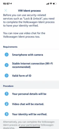

Don’t know about the auxiliary heater, but you have to unlock the unlock /lock feature via ident process. See grab from my phone below. Not completed myself yet. If you click into the lock/ unlock at top of after open the Cecile page in app, the page it automatically opens the ident process below to fill in. Mines not a Cali btw! It’s a 6.1 70 plate high line panel van conversion, we connect came as standard. 2A0D579C-2B72-456B-912F-8C047AF9300D.png

Thanks for your response. The problem is that with the MY21 T6.1 Cali, lock/unlock doesn’t appear as an available function in the app so you cannot start the ident process!
