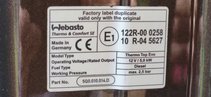

My Van has a sticker which says 'Webasto Thermo & Comfort' on the door pillar. I understand that this is something to do with pre-heating or rapidly heating the engine cooling circuit in cold weather. But can anyone explain (in simple terms) what / why VW installed this? I don't want to know how to upgrade it or control it or modify it - just what was the original intention and how can I tell that it is doing anything? There don't seem to be any controls in the Cab.

Yes, but unlike the UK version, mine is with all the controls in the cabin.
Ok, first the smartarse answer - the basic van does not have the heater so it was a specifically ordered option to the van. It seems that most of the T6 in the UK do not have the option. Based on my collection of T6 configurations (VCDS configuration scans) well below 10% of the vans have the heater in the UK.
The second answer - the heater warms up the coolant entering cabin heat exchanger thus siginificantly expediting cabin warm up in cold temperatures (below +5C).
If interested to see the difference - remove fuse SC46 to disable the heater (T6 from November 2017 onwards).

Generally speaking AUX HEATER is installed by default on a passenger vehicle(particularly 7 seats or more -> when larger volume of air requires warm up in the cold weather).
Worth to mention is that once you have AUX HEATER onboard it is quite simple exercise to get it upgraded to a full PARKING HEATER with a programmable timer and remote controller.

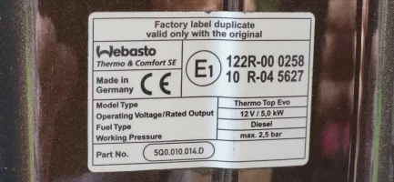

So is it a given that if the sticker is present on the door then the Webasto is in there somewhere?
Well, highly likely then but still not 100% guaranteed. Still better have a look under the van for the Webasto's exhaust pipe - see below
And without
Also a diagnostic scan would show if there actually is one onboard.
