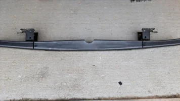

I noticed that Westfalia towbars fitted at the factory have additional supports at each end of the main body of the towbar similar to the bumper support bar that is removed.
However, aftermarket Westfalia bars do not have these additional wings attached.
To my mind, this leaves the outer edges of the bumper unsupported when fitting a Westfalia bar, and there is the increased potential for the bumper/body to be damaged if the bumper is, " nudged ".

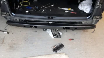

Today I set about fitting an aftermarket Westfalia detachable bar to my T6 kombi.

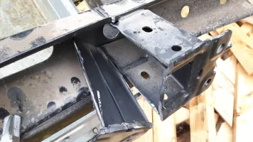

After fitting the bar I was going to cut the wings off the original support bar and weld them to the new bar, however, whilst taking some measurements, I could see that there could be a possibility of cutting the complete support bar to fit over the Westfalia bar.
So after a couple of hours of cutting, grinding and offering up, I had successfully managed to fit the support bar over the new bar.
I'm well chuffed, as not only does it now have the same amount of metal bumper support as VW intended, but I didn't need to buy £40.00 of foam support pieces that are needed when fitting the bar.

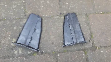

The last picture shows what was cut out.20180428_161345.jpg 20180428_171829.jpg 20180428_171851.jpg 20180428_181251.jpg 20180428_182208.jpg 20180428_182230.jpg 20180428_190222.jpg

This end bits you cut off the cross beam in your first and last picture is not primarily a support system for the plastic bumper but the first stage of the crash structure for a rear impact. The bumper beam does provide support to the bumper but needs the foam pieces to take up any movement and tolerances and to allow the bumper to flex as it all works as a system in so much that should there be a low speed impact (car park speeds) then it is a requirement that the bumper (and any lights) do not get broken (paint scrapes excepted) hence the foam inserts allow the bumper to deflect without breaking.

Exactly why I wanted to retain the support bar as the aftermarket Westfalia tow bar does not extend to provide the same level of impact protection as the original support bar.
As you suggest, without this full width bar behind the bumper skin, a soft car park type bump on the corner could well lead to greater damage as there is no metal stucture to help absorb the inpact.

Yes. Using the original crash/support bar means the top of the bumper only flexes down, when you stand on it, about 10mm.
However, the way I did it takes a lot of effort and many prefer to just spend the £40 on the foam supports.

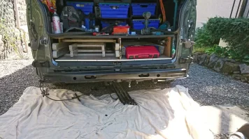

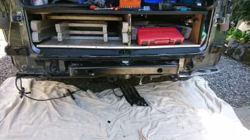

I have problems with my bumper splitting at the ends of the towbar. From what I can tell, there doesn't seem to be any support bar behind the bumper skin. It's in at VW as we speak, and I've asked them to have a look at it, but after seeing .50's 5th pic down, I'm starting to think they have removed the support bar completely. Doesn't look right to me.

Sorry Pauly, excuse my ignorance. I'm not exactly sure of the set up behind the bumper cover. This is my van. Are you saying I should have the foam supports or not? My bumper cover seems to be sitting directly on the cross bar of the towbar, hence the reason for the 2 splits.
If that’s a factory Kombi then you should just need the two self adhesive foam supports to brace the bumper and stop it bowing down onto the internal strut
Did this mod myself a few days ago when refitting the westfalia bar I removed from the fire van. I couldn't believe you'd remove such good impact protection and replace with some bits of foam!
I did this mod after fitting a towbar. I made the cuts using a hacksaw. The metal is not to thick and was fairly easy to saw. Thanks for the information.
