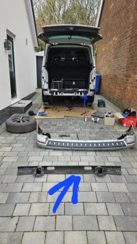

No bumper stiffener required for post 2015 vehicles that have rear seats (or something along them lines) Anyway, the Caravelle already has one in place that you reuse. I also butchered the impact bar that you're supposed to bin, and reused that too. You don't have too, I just liked the idea of the extra protection. A good angle grinder is required if you want to go down that line.
You can see the top blue arrow pointing to the bumper stiffener and the bottom bit is what I chopped up to reuse. 20240412_130050.jpg
Good info, thanks. I'll pass this on to my mechanic. I don't trust myself to take our bus apart properly and I certainly don't trust myself to put it back together. I'm unsure as to why you might get rid of the impact bar. When the tow ball is not attached, surely you'd still need it? Thanks.
