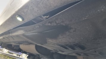

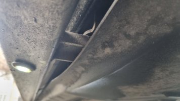

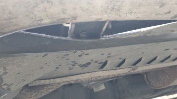

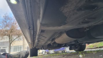

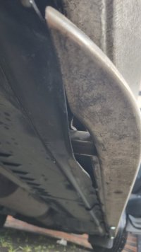

VW don't trim the plastics on the sportline.
They just bend them out the way . (so why not do as they have done?)
And let them sit over brackets after.
mine been the same way for 5 years - no issues.
I'll add a couple of pics.
Mine were fitted by Salop Vans and they cut a substantial piece of the under tray away so I have bought the plastic protrusions that fit under the edge of roof tiles cut it to shape and pop riveted it in place to keep the water and crud out especially where I’ve fitted My diesel heater.

They are OEM Sportline bars that come with the LED puddle lights. . .
1679139937356.png1679139974647.png1679139967182.png1679139958102.png1679139950394.png

TBH the VW factory dont fit the bars or sportline kit,
thats done in the UK by a VW appointed choachworks company.
TBF i think its a good way to do it, as it stops all the road grim getting to the underbody.
and once they fitted, you never have to get to the bolts again . . . . so why bother cutting the under trays?
