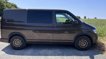

So looking to change my springs due to corrosion. Currently sat on -40 springs.
What's my best option as I am running 235/55 R18 All Terrain Tyres.T6 LWB 4MOTION
-40 again or back to VW standard? I can't find anything in between and the side bars slightly rub the ground when pulling onto my drive. If I stay -40 will probably remove the bars.
Could do just springs or full kit.
All Terrain are an off-road capable tyre and your having a 4Motion suggests at least campsites. So by -40 does that suggest a drip of 40mm ten return to stock height at least Fit Koni with new quality springs from someone on here. Most people would be better off with just AS tyres such a Cross Climate or something similar from another quality manufacturer they would give better characteristics for on road use and do mos people for trudging across a camping fields most of the year. Of course AT will out perform them when the going gets boggier or tougher as AT are built tougher and will take more abuse and scuffs.
Hi. Thanks for the reply. Yes, currently dropped by 40mm so would not want anymore than this. Ideally something in the middle at 20mm but that does not seem to be a thing unless I go air.
This is mainly a leisure vehicle and will spend a lot of time at events going in and out of boggy farm fields which are often filled with stuck vans. The ride quality is a lot better than I expected and as not doing huge miles was a compromise I was willing to take to not get stuck.
