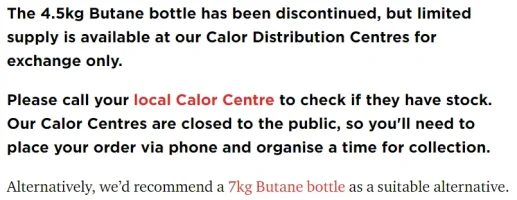

And just to throw another spanner in the works, Calor have discontinued the 4.5kg butane bottles.
