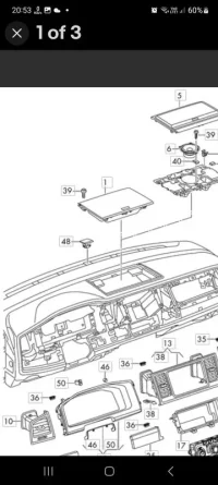

What is missing here on the dash?
A blank cap.
Edit-
Or as comments below
Or the receiver plastic for the front screen blinds in a OEM camper. --- that's part of the top storage pocket and not this piece.
Hmm....
Not sure on the part number below...... But just an idea of what your looking for.

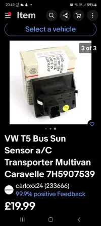

Hmm, I’m guessing it should have a blank there on models without climate control then as mine has nothing there and doesn’t seem to have a wiring plug in the hole (that I can feel anyway).
You need someone with a blank there to remove it and see what the part number is.
Pete
Makes sense as it’s for the auto adjusting of the climate.
