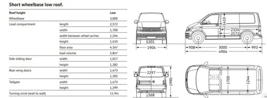

I'm planning to cover the rear panels in suedeliner, does anyone have a rough idea of how much would be required to cover them. I have a swb with barn doors and windows in the sliding door and panel opposite. It comes in a roll 1.5m wide
Roughly 2.5mts per side and 1.7mts across the back. I'd of thought 7mts would do. But to be sure why not get ya tape measure out?
