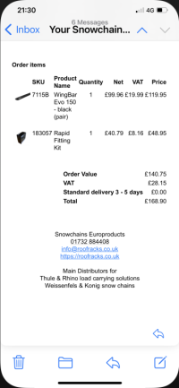

Here is the pic of my set up. I’ll see if I can find the footpack number. I have black wheels and these bars are part of the vans look. I way prefer it myself to the classic VW roof rails look36445A81-A539-467F-9303-37BB6778439B.jpeg

Here are the foot pack and wing bar details. I recommend get the lower fitting of the 751 and 753. I see no reason for the larger ones for any use.
