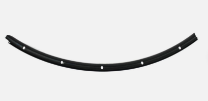

Hi! Just remove the old tabs and the new seal comes with the tabs installed, you can push it just in to place.
These are known to fall off and atleast on my experience, if your car is in subzero temperatures a doublesided tape between the seal and door panel is a good thing to add.
