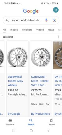

So I orginally want lv3's from leighton vans. However I have since seen some supermetal tridents in silver. Very rare and waiting upon a wheel place to confirm a possible delivery of a set.

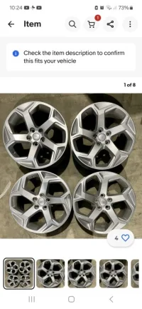

Now my predicament is i have since discovered that range rover wheels also have a similiar fitment and are load rated.
Im looking at a set of 5 split spoke 5084's in silver.
The wheels in question from the RR are
20inch 8.5j et47 cb76.2mm.
I know I will need spigot rings, will the oem alloy wheel bolts from my van be compatable with the RR wheels, or do I need land rover ones?
Will lower the van potentially 40mm via crs performance kit.
Will running a 245 45 20 tyre cause me any rubbing issues on the RR wheels?
Will look at 255 40 20 for the tridents as these are 9j
