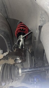

The longer the bar the less stiff it is .
I.e. the inside holes tighten things up nicely .
Tried the tightest first , test drove it and then tried the other option......quickly returned it to the previous .
