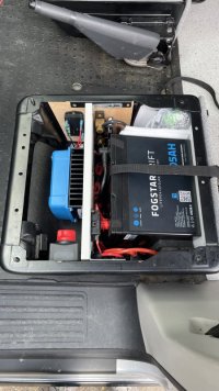

I used the non isolated Victron Orion TR30 for 2 years, it worked well but did get hot! Not much more money will get you the newer XS50, perfect product!
The XS is the newer version that is smaller, runs cooler, has more features in the software and can be down rated to say 30A. I have the older 30A (with a Drift 105) and it is fine but a bit bigger and gets a bit hotter (never been an issue). The 18A is a similar size and charges at just over half the speed. Both will save you a few notes if you are on a budget. Doesn’t matter if it isolated or non-isolated, you would just need to run 2 negative cables to ground on the isolated vs 1 on the non-isolated. The isolated is designed for glass fibre boats (and alike) where neg cables are used rather than the chassis.
