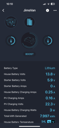

I am just back in from wiring it as I thought in my own question. In my case I have wired all of the negative sides, including solar and the RENOGY DC-DC -ve to a -ve BUS and wired from there to the P-. The B- is wired directly to BATT -ve and from BATT -ve to vehicle chassis.

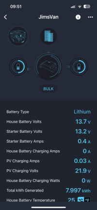

The shunt is reporting the solar panel charge current (and any disharge) in the DC Home app OK albeit that it varies a bit from solar input amps showing in the DC HOME app DC-DC 30 device. However, I suppose it gives me a SOC reading although not entirely confident how accurate it is possibly because I can't trust how balanced my Renogy battery cells are.
For £50 cost in my case, the shunt works, but I can see why folk go for the pricier Victron. You get what you pay for in life I suppose.
