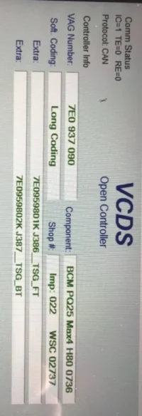

Will NCM support MFSW & CC retrofit?
Hi guys will this BCM support MFSW and cruise control?
Thanks in advance
Below a VCDS scan from a van which has MFSW and adaptive cruise control. Seems to match. However, I don't know how the subsystems are related to this.
Code:
Address 09: Cent. Elect. (J519)       Labels:. 7E0-937-BCM-V1.clb
   Part No SW: 7E0 937 090     HW: 7E0 937 090
   Component: BCM PQ25 Max4 H80 0736
   Revision: B9080001    Serial number: 0771 316150034
   Coding: 62F8793A0A21209301284F602DEB87F4C0B47389E04579C03204003F0860
   Shop #: WSC 32611 002 104857
   VCID: 688AB211027AA5A7DA8-803C
   Subsystem 1 - Part No: 5K7 955 559 B  Labels: 5K7-955-559.CLB
   Component: RLS 181115 03  37  0059
   Coding: 0228EE
   Subsystem 2 - Part No SW: 7E0 959 801 H    HW: 7E0 959 801 H  Labels: 7E0-959-80X-V2.CLB
   Component: J386__TSG_FT  003 8654
   Serial number: KU0KU005111553091947
   Coding: 0400A0
   Subsystem 3 - Part No SW: 7E0 959 802 H    HW: 7E0 959 802 H  Labels: 7E0-959-80X-V2.CLB
   Component: J387__TSG_BT  003 8654
   Serial number: KU0KU004111553084929
   Coding: 1400A0
   Subsystem 4 - Part No SW: 7E0 959 442 A    HW: 7E0 959 442 A  Labels: 3C8-959-537.CLB
   Component: E221__MFL-DC1  H02 0103
   Serial number: 29150002250340125463
   Coding: B4FFFF
