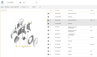

Part 1 is the main mirror part and includes parts 3/4/6/8/9/11
As long as your glass and painted rear housing has survived then that all you need and the mirror, cap and aerial can be swapped over to tue new unit
Listed price is £262 + vat for the main unit
