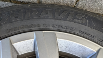

Winter tyres and wheels included in the purchase of my new T6.1 just arrived from the main stealer by courier.
It's incredible that they managed to fit car spec tyres instead of van tyres to the steel wheel rims they sent to me.
My question is are 215/65R16 102H Michelin Pilot Alpin 5 suitable for a T6.1 ?
The original tyres are 215/65R16 C 106/104T LT

The van is a T28, you can see the photos of the tyres in question in the above previous post.
