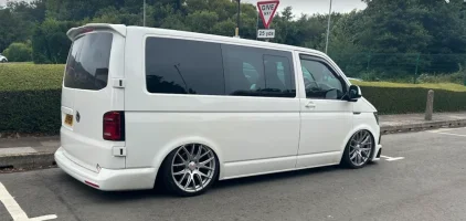

I'm new to the forum, so please excuse the obvious... but having searched and read through the many threads I can't find a definitive answer. I'm running a 2017 T6 T30 campervan conversion, lowered 40mm on 20" wheels and interested in knowing what winter wheel and tyre combo members have/running in the UK. Seems there is lots of choice of 16-18" wheels but few 19" and hardly any 20"s.
  1. Who runs 20" winter tyres on a lowered van? and what tyres?
  2. Who runs 20" wheels on a lowered van then switches to smaller wheel size and winter tyres and what wheel and tyre combo works best??
My thoughts are
a) Switch to a similar size 20" winter tyre 103 load rating..Tyres limited to choice but won't give additional ground clearance...
b) Acquire a set of smaller wheels with winter tyres fitted, but not sure what size/spec to go for as they must bolt straight on and must look reasonable and not silly given my vans lowered...
Your thoughts and comments appreciated

Thanks for the info, appreciated... I was under the impression I need 103's, so a 101 load rating does open it up for tyre choice. The van currently sits on 20x 8.5's 245x45s 103s on front and 20x9.5" 275x40s on 106's at the back and sits/looks/handles well. I'll look at 101's and see what's available.
Having specc'd my build on staggered 20"s with decent rubber only 6k miles ago, I'll be keeping them. Shame I've winter sets of 19"s and 20"s from previous cars but neither right for the van for different reasons, so they'll be going on ebay to part fund the new rubber.
Your'e quite right, living in North Yorks we do get snow every year + we winter camp with annual trips into the Highlands and Isles between Christmas and Easter, so a decent set of winters is needed...

Sorry but I wouldn’t say she is sitting well based on your original photo. Although it’s probably a suspension issue rather than anything to do with wheels and tyres.
Your van looks to have the common campervan rear sag - which at worst can be dangerous due to incorrectly weighted front vs rear for braking.
Probably due to lowering springs not handling the weight.
I had the same issue albeit perhaps not as bad…

No sag...I've since fitted Bilstein B8's since this was taken.
