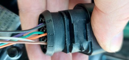

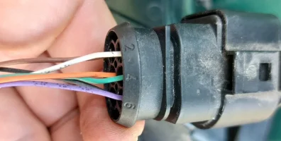

Hi everyone, I've just seen this thread as I am about to buy a G900 and have been looking how to connect to the reverse light so that the "reversing lines" come on when you select reverse. My van is a T6.1 (2020) with factory fitted LED lights. The photos below show the loom-cluster connector but the wire colours don't match anything I have been able to find on line.
Can anyone help?

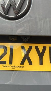

Just thought I’d post a pic of how I ran my rear camera wire on the G900 without drilling the body. It’s possible to run it through the number plate light. I hate drilling holes in a perfectly good vehicle if I can possibly avoid it. Looks quite neat and easy to do. It’s a 6.1 with tailgate, did use the extension wire as it’s a camper conversion so had to go round the houses a bit to hide all the wiring.
