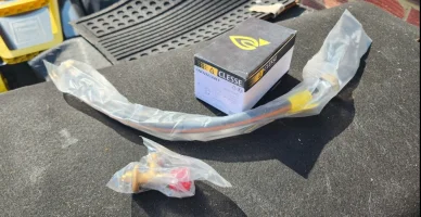

Nice one BES - Next day delivery.

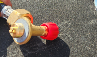

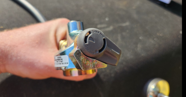

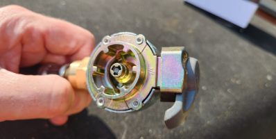

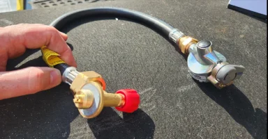

bish bash bosh . . .
with this fo rthe big blue end . . .
and this for the little blue end...

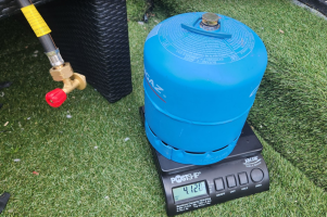

so first task will be to refill my original 907 . .
my original bottle thats assumed running out - 4.1Kg - 15%
so i was right to look at getting a replacement . . . this wont last the next 4dayer.
going by this chart . . . a full bottle is 6.4kg
my current bottle OLD is 4.1kg(15%)
so i need to add (6.1kg - 4.1kg) = 2.0Kg of liquid gas. which should take me back up to 90% full.

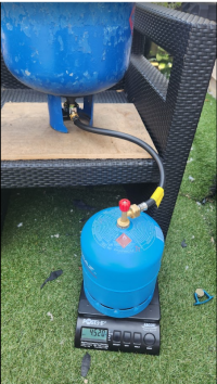

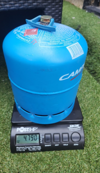

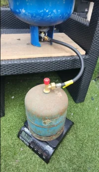

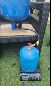

ok here we go. . .
can is at 4.1kg and around 15% . . .
donna bottle upside down, and above receiver bottle. - gravity assistance.
both valves open. . . . . . . . .
and. . . . . .
and. . . . . . .
well, wait, . . . it was very slow.
took around 3mins or longer. - i was surprised.
i kept checking . . .
i think my main 14kg is running low. . . it feels like there is maybe 10% liquid sloshing about?
maybe thats why its very slow?

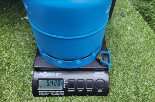

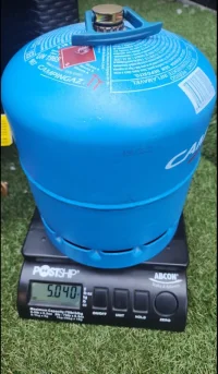

either way, i stopped at 5.4kg.
which, when the hose assembly was removed gave as a final weight of 5.0kg.
im happy with that. . .
that should be around 50% . .
so in theory i should be able to add another 1kg. . .
but it just wasn't flowing. . .? - the bottles were connected, but the weight just wasn't going up anymore.
assuming that both bottles now had equal pressure,
we need to rely on pure gravity to get more liquid in the bottom bottle,?
as gas vapour/bubbles travel up to the top bottle.?
either way . . . i got board waiting.
so ended the test.
the final out come and slosh test.. . . . . ?
yep the 907 now defo has at least half the volume now full of liquid gas,
verses the small amount before.
so id say that was a success. . .
now i just need to work out how empty my 14kg bottle is and look at getting a replacement refill.

and a note to anyone doing this. . .
remember to purge the link line after, as its full of liquid gas when removed from both bottles, . . . i just opened the 907 valve end and let the pipe vent off, as the liquid boils off to gas instantly.

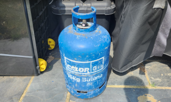

15kg calor Butane
It will have a tare weight on it too so so long as you have a set of scales in the range you should be able to work out?
Bathroom scales?
Luggage scales?
Remember my analogy of two coke bottles with a pipe, you do need to think about where the "air" is going when you fill, you might find manipulating the larger tank to try and allow the gas phase to equalise helps and then try to get more liquid phase in.

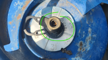

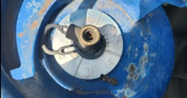

the 15kg bottle has this ALU ring on top.
which says 31 / 14

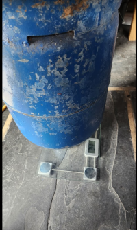

and the bottle is almost empty,
and its weighing 16kg atm.
wondering is thats 31kg full,
and 14kg empty?
as mine is 16kg now and feels almost empty?
edit:
looks like a wide full/empty range. (suppose depending on bottle design)

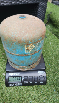

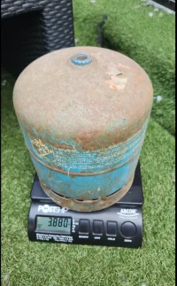

ok, just to add to this. . .
i have another manky 907. . . that weighs 3.8kg,
so empty.

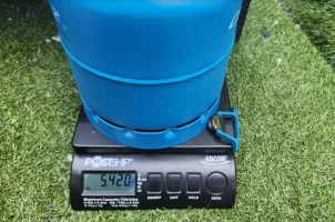

done another re-fill job,
final result. the 907 now weighs 5.3kg,
so a 1.5kg gain, and i feel 1/3rd liquid gas in the can..
now the 15kg bottle weighs, 14.8kg.
there is a tiny amount of liquid left. . .
so i think what's happening is that, this union / valve is screwed in to the tank.
and a small portion of it is protruding inside the tank,
causing a lip inside, that's stopping every last drop, from draining out.
so if i added 1.5kg to this bottle,
i can only assume its down to the pressure difference, as in the empty one had much lower static pressure, which helped the larger bottle push the liquid in. .
where as the other 907 had equalised pressure, so only gravity to push the liquid gas down into the 907. . .
im also assuming that the proper filling stations etc are using much higher pressure to charge the bottles, to force the liquid in.
anyway - now going to get that 15kg bottle swapped out for new shiney one.
