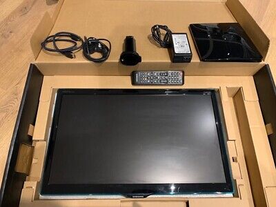

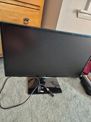

I bought a Cello smart TV...was not impressed with the UI, the sound was terrible. I eventually put it outs its misery by inadvertently melting it on a heater, so a bit of a blessing in disguise. I then made a discovery, some of the regular samsung TVs are powered by a 14V mains adaptor...which conveniently work fine at 12v. There are several models that are suitable...just look out for the ones with a mains adaptor generally available on ebay for around the £50 mark second hand. coupled with a chromecast, you have a decent brand 12v compatable TV for next to no money that can also be used via the mains adaptor if you chose to on hook up. it will need a little basic electrial know how however as you would need to make up a cable to connect from a 12V outlet to the TVs DC barrel connector input, but its not rocket science.
