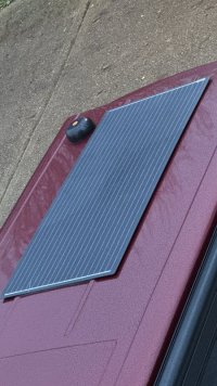

I did speak with All Seasons earlier this afternoon to try and find out about the PV panel - the guy there is fairly new so is finding out for me, but in the meantime does anyone recognise which brand/model it may be? It's "waffer thin", no ally frame, connections on the underside and discretely dropped into the pop-top. No branding that I can see (obvs).
I think I may have answered my own question, thanks to another thread on solar stuff...and it entirely makes sense if I'm correct....Photonic Universe; it's a PU PWM controller, so at the moment I'm making the assumption that a solar kit was bought for the build.
