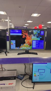

Been and looked at this Tonight in curry's. Almost bought it but the screen looked blurry, with the small offers and tech being shown on screen etc.
How's yours? Is it loud enough? The sales assistant would get me the remote

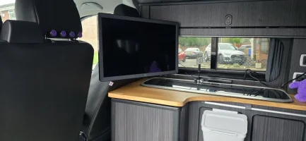

Having been out to the van that isn't the one I have. This is. It has a great screen on it. Speakers are loud enough but I paired it with my Bluetooth Bose speaker and that is awesome. Loud enough for 6 of us sat around it watching MotoGP when we were at Santa Pod last. Has a wide angle screen and great on cinema mode even in bright daylight

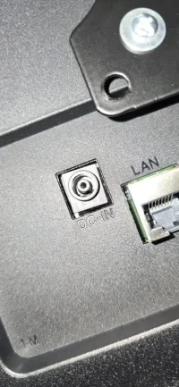

Think I'll go with that. I'm thinking of buying a 12v dc lead and wiring it into my 12v electrics via my step up stansformer if needed

You need a 12v to 19v step up. These run at 19v 2 amp draw. I wired one in to my fuse bos and have an on/off switch to knock it off when not in use

I've just had one delivered yesterday, as I had planned to get a Samsung tv originally. I'll get that wired in
