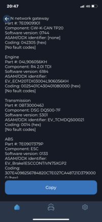

Hello, thought I would report back in the hope that somebody has any experience similar to this?
Just plugged Carista in and the scan shows 0 faults across all the ECU’s. Had a look at the DPF and says it is above the limit for a manual regen with a soot level of 60g.
Do you think we have the culprit? Although when does this put an engine light on? Would have thought if that dirty it would have told me?
Thanks for your help
Please post "Detailed ECU info"-report (under Carista Service menu).
Soot level 60 g inhibits DPF regeneration - the DPF needs to be replaced (or cleaned). Also ECU defnitely should report that as fault. Was there any mention about engine remap?

Hello, so checked again and no faults or warnings at all. Have attached the detailed engine report.
No soot in the tailpipe. Is this because its all stuck back up at the dpf?
