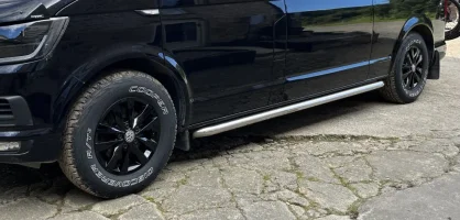

Just done the first 500 miles (including UK motorway and French roll up to 130kph) on my new Cooper Discover AT3 Sport 2 tyres, fitted by the alloy refurb/powder coating company straight after they’d powder coated black (see picture above).
No spacers, standard Clayton 16inch wheels on my T32 long wheel base.
Noticed the speed was slightly under reading (~5%) so coded the ‘k value’ with OBDeleven from 5 to 4 to make sure the Speedo read in line with GPS speed
Tyres were cheapest on 4x4tyres.co.uk
Wished I’d done it sooner, ride is improved, no change to loudness, and the Cooper’s are less aggressive than the BF Goodwich All Terrains. It also looks so much better.
Maybe a slight impact to mpg but hard to say as we were fully loaded with bikes etc.
“225/75R16 Cooper Discoverer AT3 Sport 2 All Terrain White Letter 104T Tyre” was the exact tyre.

Hi. @Derty Barst Could you post a full close up side on pic of your black Clayton wheels please?
They look really good and I'd like to Photoshop it on to my van to see how it goes with my blue and black scheme. I'm on factory Clayton but want to go black wheel. Powder coating what I've already got may be the most wallet friendly solution!
Hello Tee I will do it today for you , I had them sprayed up at Wheel Workz in Crawley Sussex ( near to where I live ) as it was a cheaper alternative to new wheels , the VW valve caps we’re bought by my son ( he uses the van sometimes ) , it roughly about 350 quid but they did a fantastic job , only problem is I make my wife and son park it about 200m from any kerb to protect it ,
