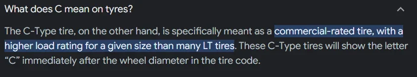

My front tyres are worn and need replacing but I must confess to being completely confused about the tyre rating. The tyres are marked 205/65 R16C, but when I look up tyres guides, it makes no sense as the C would imply a speed rating of 37mph and the load rating 16 doesn't even exist What am I missing? The van is a T6 T30 van modified as a camper.
16" is tyre diameter
Further explanation:
They’ll be a load rating too something like 103 - particularly important to have the right load rating on a commercial vehicle!
205mm is the width.
65 is the aspect ratio 65% of the width.
R is radial.
16" is the diameter.
C is Commercial rated.
Thanks all. Yes sorry, I did figure that 16 was the diameter. I was expecting a suffix of the form e.g. 90V but I have a C as it started life as a van. Thanks for all your help
