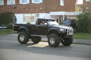

I love the big rubber look...but sometimes practicality takes over. i took the same journey down this road on previous vehicles (hilux's!) at my worst i was running 38.5/14.5/16.5 (thats 368/76/16.5 in metric!)..i sold that one years ago..it looked and sounded nice, but i could literally watch the fuel gauge dropping on account of the 5.7L V8 fitted.
You got me interested at the V8 Bit!! Good man
it had a small block chevy crate motor fitted...used to go well comparatively speaking for a pickup. the fun part as always was the build and getting it to look the way i wanted it...then hardly used it, so it got sold on :(

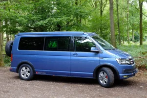

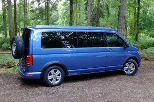

T32 TDI 150/map180 with 420 torques 235 65 17, 20mm spacers and no rubs etc, +25mm raise, clearance remaining 10mm 6% rolling radius and the speedo is true rather than a bit optimisic. Softer ride is good, not noisy but you stay slightly longer in the gears and 6th is only on the motorwy
Falken Wildpeak
