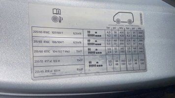

Hello, as I understand it the C rating is to show that the tyres are correct for commercial vehicles, lesser-rated tyres may not cope with the loading exacted upon them.We run a fleet policy, and I have had this conversation regarding "C" tyres, they didn't give a monkeys. So you can have your own conversation with your own insurer regarding this matter. As I understand it, the C tyre is a tyre that is designed for the fleet market, i.e it lasts along time. In my experience that is it, pretty rubbish in every other aspect. A 106xl tyre with all season designation is far far better than any rubbish "C" tyre.![]()
It’s all to do with tyre size, load rating (e.g. 103) and max pressure. In smaller sizes such as 16” to get a sufficient load rating (103) and high enough max pressure the tyre will have been made for the van market (rather than lighter cars) and will be C rated. Larger size tyres (e.g. 18”) will have some designed for larger cars/SUVs and come with a load rating and max pressure capacity high enough for the T6. These will not be C rated, partly because they don’t need to be as the load capacity is high enough and also because there is not the market for these larger tyres in the commercial sector.Hello, as I understand it the C rating is to show that the tyres are correct for commercial vehicles, lesser-rated tyres may not cope with the loading exacted upon them.
