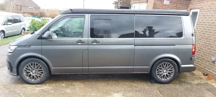

Similar to others I'm currently running ring 255/45/18 on Momo revenge 18's. Spring suspension 40mm lower than factory. Van is a LWB T6.1 t30 manual, converted to a camper but also weekend daily drive.
Speedo reads bang on at the moment.

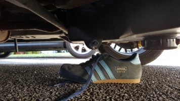

My ride height is sadly limited by the underslung water tank access cap which is 70mm above the road surface so not full gangsta here :geek:...
Draining the tank and the pump trying to escape.

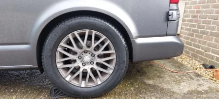

I was just looking to get a slightly softer ride and maybe fill the arches a little better for aesthetics. I've almost settled on 255/55 after chatting to conversion company today. All road and pot hole use. :-)

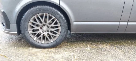

Went with Michellin Crossclimate 255/55/18
