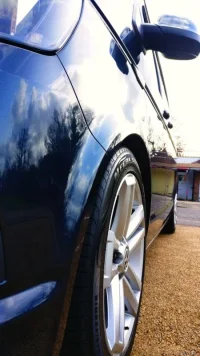

0B537F6F-7150-4FF0-BFB6-D534D2562896.jpeg 8D6C952C-1B6C-4948-AE59-1343CB8CEE5F.jpegHad this setup on my T5 (now sold with Devonports, kept the Cantera's for the T6).
Did approximately 20k miles and still plenty of tread left - I highly recommend the Goodyear Eagle.
