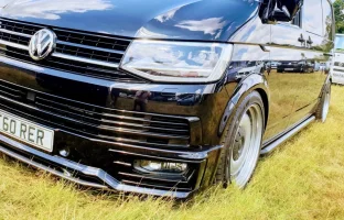

The profile is basically the side wall of tyre and is expressed as a percentance of the tyre width.
Narrow tyres on wide rims give a stretched look, and wide tyres on a narrow rim give a bulged out look.
I prefer a square or flush sidewall profile and have looked at 275 wide tyres for my 9" wide rims, hence asking for a photo. ( if you can ).
Cheers.
ok .50
i had 8" rims and they were slightly bulged so a 9" would look about flush.
i dont have them anymore sorry so no pics.
