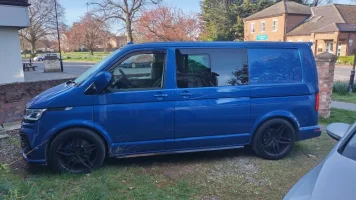

Problem with 19s is that there are very few tyre options. I'm on 20s, 60mm drop, coilovers, now (new van 2 weeks ago). Ride is good(no body roll etc) but definitely 'firm'. But it does look sweet ...
Not any good ones yet but need to take some, will post some a bit later. It's a Bognor Motors van so it's their suspension setup on Bilsteins and 265/40/20.
.Previous T5 was on 235/55/19 with Eibach 30mm springs drop and the ride was significantly 'softer' though with more body roll.
I did drive another 6.1 on 20s while I was looking which was just lowered with springs (wider tyres I think) and the ride was very crashy, didn't like that at all.
