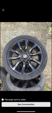

Just landed a set of Range Rover wheels (in a real state) for a very tiny price as a little project.
They are 8.5Jx 20 ET58 as most are, obviously a lot of people run Range Rover wheels, my question is what size tyre do people run and what suspension height? With the current massive tyre on the look mad stood against the van.
I’m thinking of going 255/35 to retain the same (almost) diameter as my 16 inch stock wheels but open to advice on this also.
Will post pics of the wheel progress on my van thread.

Depends on your van - is it a T26, T28, T30 or T32?
275/35/20 is the official tyre fitted by VW but only upto and including T30.
265/40/20 is load rated for T32 so will work on all vans
You will also need spigot rings and different bolts for the wheels to fit the transporter

Thanks for the info! Was just about to ask about the wheel bolts! I assume all RR wheels are the same seat? Flat face inside the hole? The bore looks quite big……..obviously I forgot to measure the inner bore
