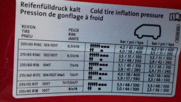

The tyre manufacturer sets the Maximum tyre pressure, but they have no idea what vehicle the tyre will be fitted to so the correct pressure to use is the one set by VW which depends on your van and its weight. There should be a sticker on your van like this which will guide you;
Agreed. The table shows that as the wheel radius increases, the tyre pressure goes down. So why does somebody pump 52psi in an R20 when that exceeds the safe design. An educated guess would be somewhere lower than an R18. At www.tyrepressure.com it cites 36psi to 40psi for a 245/40/r20;depending on SL or XL. Think I would rather be safe than looking pretty
Even the the VW manual says "never exceed the maximum tyre pressure which is given on the sidewall of the tyre"
As you can see from the plate above, there’s pretty big variation depending on loading. This means you’ll likely need some experimentation. Some you can do by eye, looking at the tyre tread contact but as time goes on you can monitor the tyre wear too. For what it’s worth on our LWB camper we run 235/55/17 at 48psi front and back.
Sounds sensible. Mine is a SWB. There is nothing in the table that gives a comfortable correlation as it cites narrow and wider tyres with different profiles. So educated guess time: I reckon I could go 44psi front and 40 on the rear but will adjust as I go. Cheers
