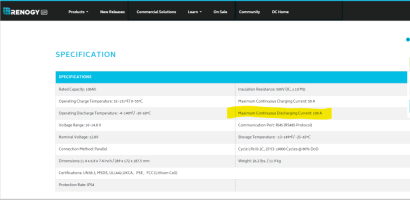

example Renogy lithium, max discharge is 100A per battery.
so for 2000W you need two of them.
yes . . . i think thats because id the 120A max continuous discharge rate.
though it can peak at 240A
so depends on your use case and loads.

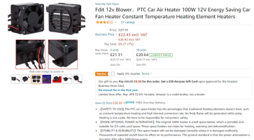

saying that i do have these 100w and 200w heaters for load testing - they are very effective with a decent fan.
100w
200w
jokes aside - you need to look at a diesel heater for heating
using 12v batteries for heating is never going to end well - too inefficient.
